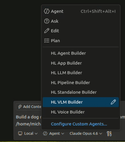

When you open the hailo-apps repo in VS Code with GitHub Copilot enabled, it automatically loads the .github/copilot-instructions.md file and all agent definitions from .github/agents/. This means the agents are immediately available in the Copilot Chat panel.
Invoking an Agent
Open Copilot Chat (Ctrl+Shift+I or the chat icon) and type:
@HL App Builder person detection with tracking on USB camera
Or go directly to a specialist:
@HL Pipeline Builder pose estimation game with scoring
The Agent Interaction
The agent will respond immediately and ask 2-3 design questions:
After you answer, it presents a build plan for your approval. Only after you approve does it start creating files.
